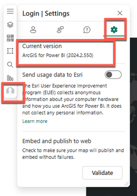

Besides what @AlagiriVenkatachal  suggested, could you please also check if you are on the version 2024.2.550 for ArcGIS for Power BI? We fixed the blank map issue in the version 2024.2. The latest version of ArcGIS for Power BI is there when you are using the latest version of Power BI Desktop.

I have the most recent ARCGIS for PowerBi (2024.2.550), and the PowerBi desktop version (January 2025) mentioned above cleared the caches, etc listed above and still my maps are blank. Do I need to update something else? Clear other cache?
