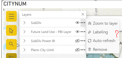

I have published GIS layer on ArcGIS Organization account. I tried to join the Power BI data attribute to GIS online layer in Power BI. However, the Join Feature is not showing here:
The Join Layer in Power BI is also added in Fileds and this column also available in GIS layer

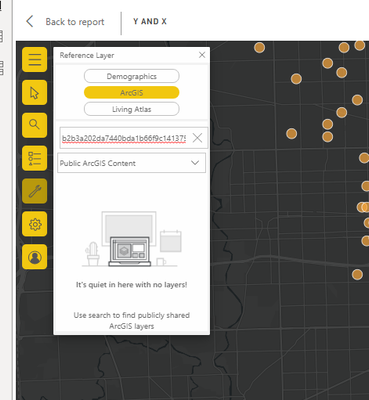

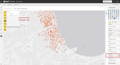

It looks like you are following the steps properly, but, as you stated, it doesn't appear! Is it possible to make this layer public so I can test it on my end? I won't need the data from your PBIX file to test this. I tested this on my end and I see the Join layer option.
If you can make it public, I will just need the map ID. It'll make it easier to search.
Lastly, what type of layer is this? I am wondering if there is a layer type that is obscuring the Join layer feature.
Let me know what you see!

Interesting... the dialog says its a Feature Collection. We'll have to take a look at this, but I would try with a Service to see if there's a difference.
AnthonyLatini
@RezaSardari - I tried to look this up in our visual and I do not see it. As @Anonymous User mentioned, this might be because it is listed as a Feature Collection. If you try this on the Feature Service, does the Join layer appear?
