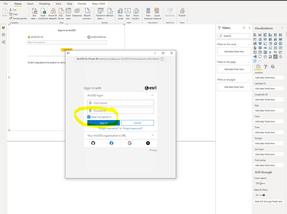

When someone signs into ArcGIS from the Report, are you also checking this option to "Keep me signed in" ?

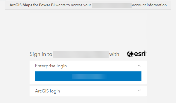

Most users will get the following prompt and then simply click the blue button.
There is an option to define the login and enter the details in the ArcGIS login section at the bottom. That does include the option to tick off "keep signed in". But like I say, most users won't even look at that. It's a workaround at best.

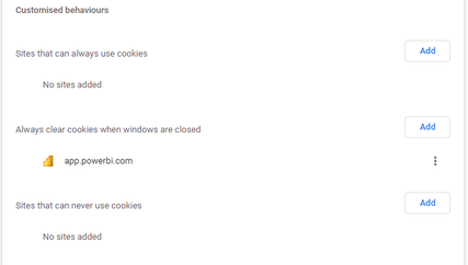

Basically, it looked like preview features changed the token expiry from 1 hour to 2 weeks.
Current workaround is to set Chrome to delete app.powerbi.com cookies when the session is closed.
Saves having to do that manually.
