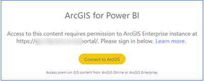

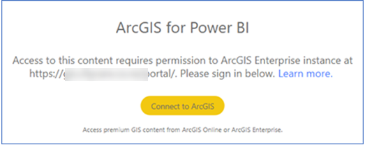

Issue 1:
Unlike app credentials that we can automatically generate and refresh tokens from a server component, for Power BI, we used a named user to run the ArcGIS for Power BI component. It logs out after 10 hours and needs to log back in manually. The GIS team won't change the security policy to make any data publicly available. What is the best practice around the authentication pattern for this use case?

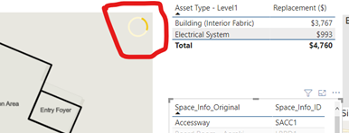

Issue 3:
"Keep getting the spinning circle once I create a join (it doesn't seem to stop me doing other tasks but not sure why it continues spinning)."

Hello!
Issue 1 could potentially also be resolved by switching to SAML based authentication with your ArcGIS Enterprise.

Issue 3 this is a bug and will have to test for a fix and confirm.
I'd love to know more about your workflows, to see if there's something else we might be able to do in place of joins or to see if we need to expand our functionality on the join feature. Please let me know if you have time to talk or direct message about this.
