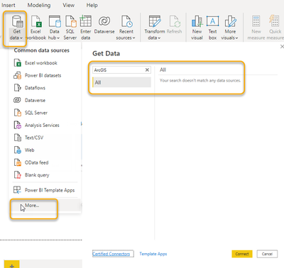

As of 10/12/2022, it's not a simple matter to use Power BI to "Get data" if it is ArcGIS data or other data with a spatial column, and heaven forfend, we actually want to load that spatial column into a map visualization, join the table it's in to other tables, and color boundaries by a value column and such.  It's tough.
By "data" I don't mean the canned polygons from a geocoding service.  I mean "our data that we need to use for our business purposes."  And I'm mostly talking about polygon geometry here.
After engaging in a 5-day crash course in learning "Almost All the Maps for Power BI" to support a gang of customers, it dawns on me that maybe one of the first ideas for "ArcGIS Maps for Power BI" or "ArcGIS for Power BI" should be right at "Get data", where it all starts for Power BI users.  If I search for "ArcGIS", "Esri", "spatial", "location", or any key words of Esri's choice, I would expect to get a pick list along the lines of:

Ok, that's it.  That's my idea.  Get data.

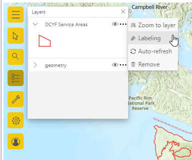

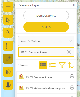

  • Power BI > ArcGIS Maps for Power BI > wrench thing > search/find/add "reference layer"
  • Layers > ... > add "Add to Power BI" launcher that converts to CSV with geometry column so I can join and relate that with my other stuff, then get on back to the map and other visualizations.  Stick it right above "Remove" maybe?

Actually, I like my alternate idea better because it re-uses all of the layers I've published in ArcGIS Enterprise and ArcGIS Online.  My Power BI customers can search/find/evaluate/get/use my data right there, and I can carry on with my ArcGIS and Tableau customers without further messing about.
Of course, this approach continues to break the basic Power BI user workflow.  Maybe we add "ArcGIS Online" and "ArcGIS Enterprise" to the "Get data" listing then search/find/etc.
