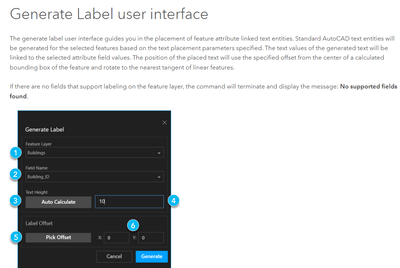

I've upgraded my ArcGIS for AutoCAD plug-in to 430 version, but I can't find this 'Generate Label user interface' function at all.
https://doc.arcgis.com/en/arcgis-for-autocad/latest/manage/generate-label-user-interface.htm
Could someone guide me for this?

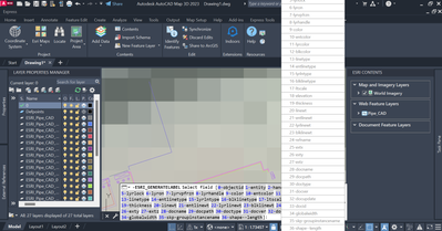

I've already tried that command and the result looks like this.

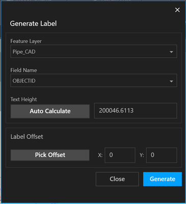

However, I found out the solutions now.

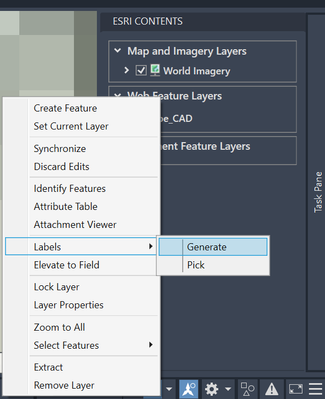

The first one is do the right click at the feature class and select Labels > Generate then the interface will appear.

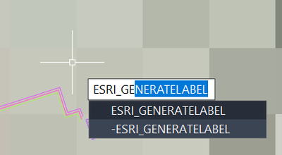

And the second one, I just know that there is difference between ESRI_GENERATELABEL command and -ESRI_GENERATELABEL command!
So that's why I can't find the interface I'm looking for.
-ESRI_GENERATELABEL command bring you to the first picture.
ESRI_GENERATELABEL command will get the interface for you.
