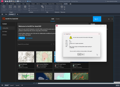

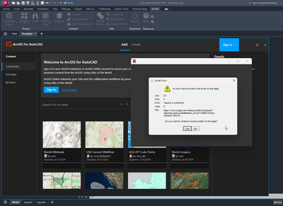

all our users started getting the two script errors below when trying to sign in using the the 420 plugin. regardless of whether you select yes or no, result is the same, blank login screen. we can login fine through a web browser but not through Civil 3D 2023. any one else running into this or know of a solution?

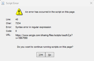

We also have a couple of users running into the exact same problem today.
Civil3D 2024 + 430 plugin to start
Updated to 430.1 and still get the same script errors at sign in.
Just tried a clean install of AutoCAD 2024 + 430.1 on a machine that has never had the plugin installed before and it's also popping up the same script error.
Hoping they'll be a resolution posted soon.

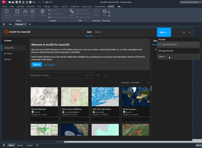

AllenP
ArcGIS Online
AllenP
Also tried adding the project portal site to login to it directly and the same script errors come up.  Never see a login box at all to enter any credentials.
