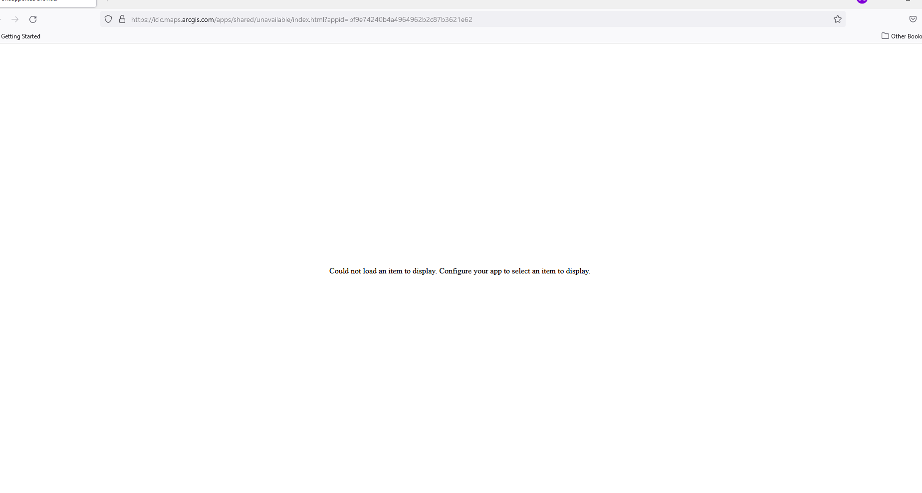

Currently, my co-worker gets the following error when trying to log in to the view the map: "Could not load an item to display. Configure your app to select an item to display."

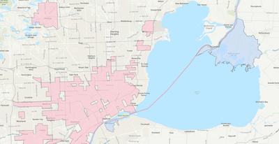

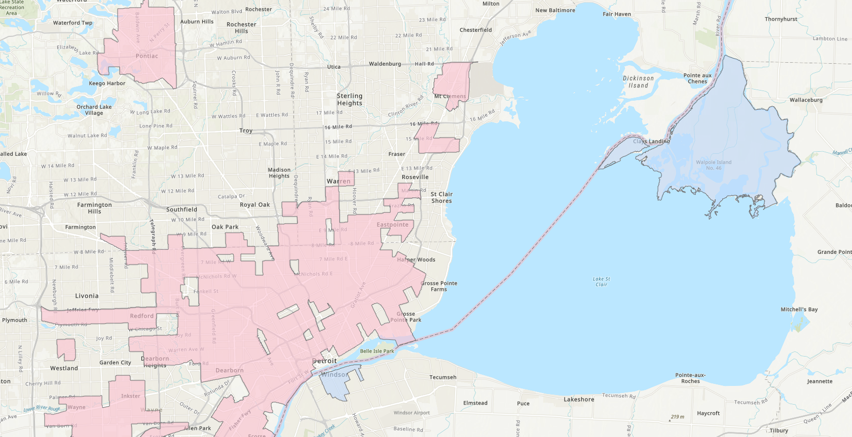

I'm able to see/access the map when I log in:

Hello dyee,
The permissions for your layers must be congruent with the permissions for your map.  The "read only" property of your layers would depend on what was chosen for the feature or web service when it was published.
Amanda Bishop, GISP
DrVSSKiran
Make sure that when you sharing the webmap app layer sharing with other member of group you can dnable sharing with group option, same time select you underlying map layer and uncheck the sharing with group, publice(everyone) option.
