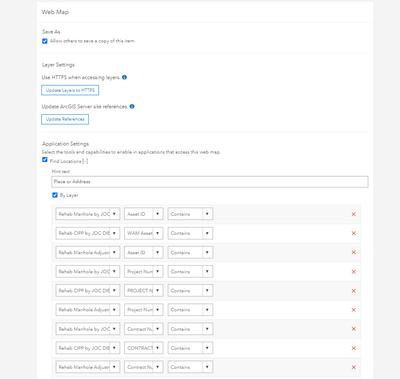

I've noticed that when I set up searching "By Layer" in a map's settings the searching works just fine in the browser, but it doesn't work in the field maps application. I've searched on the new Field Maps site and in the support forums, and I don't see anywhere else I'm supposed to enable this searching. Is this something we're not able to do in Field Maps? Set specific layers to be searchable offline?

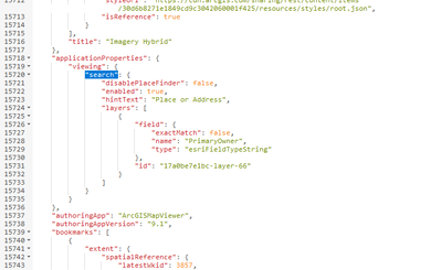

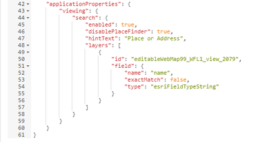

It can work ?   If you look at the map in ArcGIS Online Assistant  https://ago-assistant.esri.com/
Do you see a search in  the application properties?
It should look similar to this:
Is the feature your looking for downloaded into the offline map?
What search operator are you using, equal or contains?
What is the field type? integer, string
And the Field Name, what is it?   potentially it could be a reserved keyword that gets changed in the offline database?

4. Field name is "PrimaryOwner"

I'm having the same problem with Enterprise 10.8.1. I configured the searchable fields in the options. I've tried multiple layers with multiple fields. I'm using 'contains' and string values (no reserved keywords). Works fine in the desktop web application but doesn't work in Field Maps.
