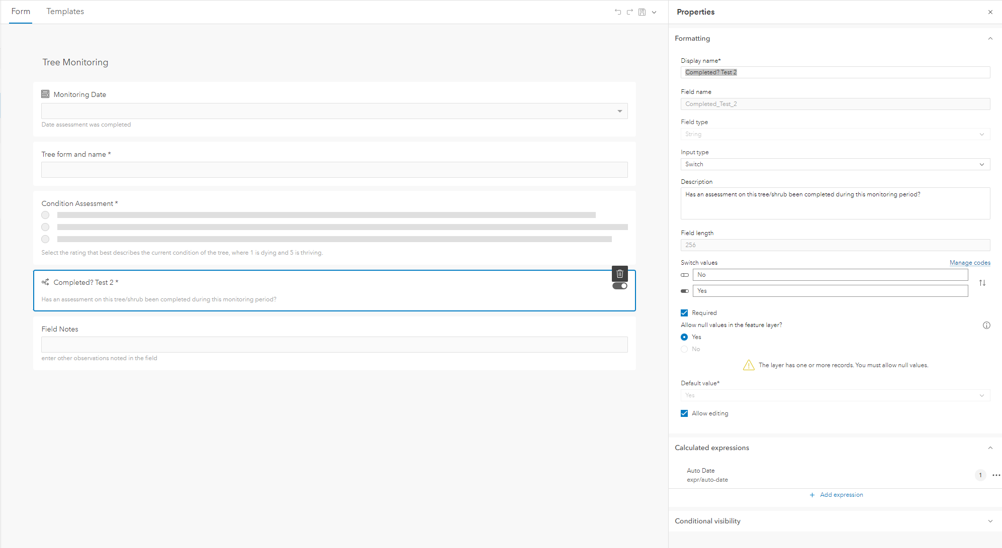

Hi, I have set a default value for a Switch field in both the Field Maps form builder, and in AGOL. It looks good in the Field Maps web app, shown in the screen shot below, but in the mobile app or using the edit tool in the web map it looks like there is no default value set.   I read a similar thread to this that was resolved, but in that case the feature layer was published from Pro. In my case, I created the hosted feature layer in AGOL from a zipped shapefile.  The layer does have existing records if that makes a difference.

Thanks to @JustinReynolds we were able to resolve this. NEW features will reference the template and stored default values. However because our layer had mostly existing features to be edited, they didn't reference the template or therefore the default value. Instead we added a calculated expression so that if the field "Condition Assessment" was not empty, then the "Completed" field was set to "Yes" (the default value I want).
Calculated Expression:
iif (!IsEmpty($feature["Condition_Assessment"]),"Yes","No")

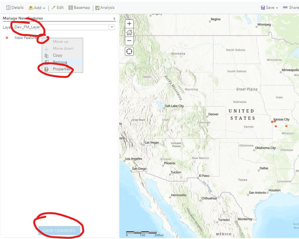

You will probably need to set the default value in the feature template for it to behave as expected.  I suspect that you will need to do this from the map viewer classic unless that field already has a default value assigned in its feature template, then you could manage it from the Field Maps Web App.
When editing the feature templates in map viewer classic, there is no need to save the map, just save the templates.
Edit Session -> ManageEdit Session -> Manage
Edit Default Value then save templatesEdit Default Value then save templates
