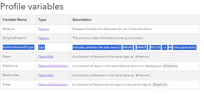

Hello,
I believe what you are looking for is the edit context/edit type.  It is a profile variable found in the Form Calculation and Form Constraint Arcade Profiles
https://developers.arcgis.com/arcade/profiles/form-calculation/
https://developers.arcgis.com/arcade/profiles/form-constraint/
Your Add is INSERT and your select is UPDATE.
// Example usage of $editcontext.editType
if ($editcontext.editType == 'UPDATE') {
    if (!IsEmpty($originalFeature)) {
        var oSelf = $originalFeature.rsrc_previous_feature_info;
        var oServiceNumber = $originalFeature.service_number;
        if (oServiceNumber == serviceNumber) {return oSelf};

WilsonLee
Thanks Justin!!! let me try to update my codes🙏
WilsonLee
THANKS again! it works!!
