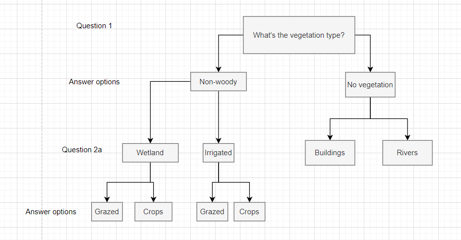

Hi Field Maps community,
I am working with farmers to map out vegetation types on their land.
The idea is that they the vegetation polygons in and fill out the attributes themselves using the Edit widget in Experience Builder.
My plan is to apply hierarchical conditionalities so the attribute filling out process is simple for them. I assume I'd be doing this through Field Maps, which would feed into the Edit widget.
The answers to choose from in subsequent questions would be based off of how they answer previous questions.
The screenshot below shows what I am trying to do.
My arcade level is basic. I understand how to use conditional visibility in Field Maps, so how to make a follow-up question appear if the first question is true or false. I don't know how to control the drop-down answers in that follow-up question based off of the answer to the first question. Does anyone have a link to a good tutorial or can provide some instruction here?
As a side note, I've set up the contingent values in Arcpro and published that layer into AGOL, but they didn't appear when I tried editing it in Map Viewer, when I tested it out in a Field Maps form on mobile, so assume too it won't work in Experience Builder.
I know as a safe and back up option, I can load each of the fields in individually, however would like to avoid that because it will take a long time, and I think there must be a better way to do it!
