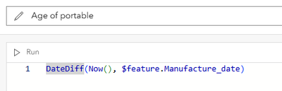

Since you haven't specified the units for the DateDiff function, it's going to return the difference in milliseconds. What happens if you format to return it in years (and round it to two decimal places)?
Round(DateDiff(Now(), $feature.Manufacture_date, 'years'), 2);

What do the calculated expressions that use the Manufacture_Date field look like?
AmberMillison
Hello, this is what I have:
AmberMillison
Thank you so much!! This fixed it!! 🙂
