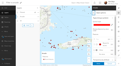

You can do this two ways.
The first would be to use Arcade in the Styles tab. An expression like this would return the flightlines for the last two years. You would have to turn off the Other category in the Style options section.
if(DateAdd(Now(), -2, 'years') < $feature['dateField']) return 'Recent flightlines'
The other option is to use a Filter on the layer. The one drawback to that is it uses a hard-coded date instead of the flexible date (two years from today) that the Arcade code uses.

SarahJorgensen
@KenBuja thank you!
I looked at both options you suggested and I think that because there will be new flightline data entered every month from now, which I will need to hide on the Field Map (so that surveyors have a clean map to work off at the beginning of each month), the simple Filter option should work well.
I'm new to ArcGIS so I didn't know about the Filter function before. I'll see how it goes. Thanks again.
