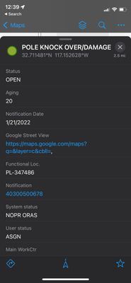

Hoping one day the Google Street View hyperlink arcade expressions will work in Field Maps?... for now we just get a broken link:

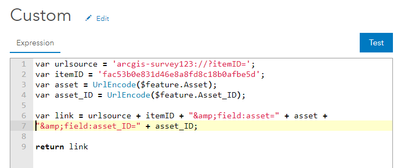

I am also having this issue...Field Maps V22.2.0 build 736.  This has been my first attempt at creating an Arcade expression in Field Maps, so haven't seen it working in previous versions.
I was trying to create a hyperlink to a Survey123 form using Arcade, but the popup doesn't display it in Field Maps and only shows the default fields.
This is my expression:
var urlsource = 'arcgis-survey123://?itemID=';
var itemID = 'fac53b0e831d46e8a8fd8c18b0afbe5d';
var asset = UrlEncode($feature.Asset);
var asset_ID = UrlEncode($feature.Asset_Description);
var link = urlsource + itemID + "&field:asset=" + asset + "&field:asset_id=" + asset_ID;
var label = '<p><strong>Asset:</strong> ' + $feature.Asset + '<br><br><a href="' + link + '" rel="nofollow ugc noopener noreferrer" target="_blank"><strong>Add Inspection Record</strong></a></p>';
return {
	type : 'text',
	text : label
It Tests okay and produces the right result, displays as expected in AGOL Map Viewer, just not in Field Maps.

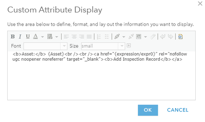

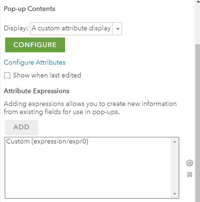

Thanks @Anonymous User, that makes sense.  Yes, I had configured that in the new Map Viewer.  I've had success doing something similar in Classic, so will just do it there.  Is UrlEncode functionality (or similar) available in Map Viewer Classic for customised Pop-Ups? I'm trying to pass across to Survey123 an attribute that contains spaces and ":" characters and I don't believe that they are being parsed correctly into the URL.
by Anonymous User
Not applicable
You should be able to use the same UrlEncode Arcade function, as far as I know.
Dan_Joyce_OE
Yep, got it.  Thanks.
For reference for others...this setup was done in Map Viewer Classic:
Dan_Joyce_OE_0-1653974257113.pngDan_Joyce_OE_1-1653974284300.pngDan_Joyce_OE_2-1653974329334.png
I also found that the url is case sensitive for the field names.  I originally had "asset_id", but needed "asset_ID".
