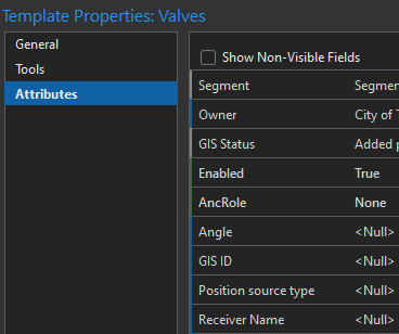

One trick to determine if a default value is going to publish, is to look for a Grey bar next to that field name while in the feature template properties. If there is a Grey bar next to the field, then it's recognized as a unique default and will publish. When tricking it, you want it to appear with a Green bar next to the field, meaning it thinks it has changed. After accepting the properties the Green bar will change to Grey. If the bar next to the field is Blue, then it will not publish. If you to click on a default drop down and select the same value, you will see the field remains Blue because it knows it is the same value and nothing changed. This is why you must first change it to something else and then back to trick it (no need to close in between).
In the example below, 'Enabled' and 'AncRole' have Green bars next to them indicating they have been altered since opening the properties (inherited default was changed to something else and then back to the default). After closing and reopening the properties, they will have a Grey bar next to them, as is seen next to 'Segment' and 'GIS Status' which were previously changed. 'Owner' has a Blue bar next to it even though it has a default value, as do all the field without default values. In the current state, 'Owner' would not have the default published with the service, but the other 4 fields will.
