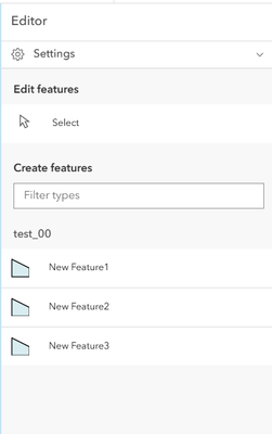

chris_del101
I added something like this using the rest api similar to what U show above.

 In map viewer I get the name of the above but nothing else works. The fields under prototype are even wrong when I go to create, and the drawing tool types have no effect.
But where can I find this in class map viewer? All I get is something like this.
