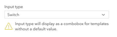

@JanetSilb_Spike agree with @JustinReynolds that what your client wants to do should be possible.  From you explanation above, I think the issue is that the field you want to be displayed as a Switch is missing default values for all of its feature templates.  do you see this warning when you select the Form Element in the web app?
Setting the default value for the field on the Templates tab should correct this.
Craig

Thanks Craig, I don't see that warning but am talking with @JustinReynolds later today.
