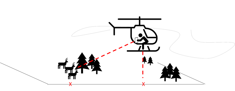

Diagram of the collection:

OIC.
Based on the graphic, I thought they wanted the auto orient tool so they could "point" the iPad at the deer off in the distance, then, looking at the map in front of them, determine based on the direction they are looking, and what they see on the map/imagery, they know where to "collect here".
