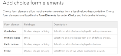

ShaunGibbins
I assume this is not coming to enterprise 11.5? The documentation that covers 11.5 does not mention the June update additions like 'Multiple Choice'
I also assume that this has only been implemented for hosted feature services?
Build the form—ArcGIS Field Maps | Documentation
SarahSaint-Ruth
Hi Shaun,
This is planned for ArcGIS Enterprise 12.2.
Multiple Choice is not limited to hosted feature services. It follows the same pattern as forms today. To use it, the field must:
  • Be a string field type
  • Not contain existing values
  • Not participate in a contingent value group
  • Not be a system field
  • Not be a primary or foreign key in a relationship
Note, if you wanted to use the other option you would need a field already defined as Field Maps can only edit the schema of hosted services.
If the service is hosted in ArcGIS Enterprise, it can be referenced in ArcGIS Online and Multiple Choice can be configured there. Folks can also use ArcGIS Online and ArcGIS Enterprise collaboration patterns.
