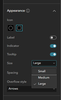

Lake_Country_GIS
Thanks for the tip. I must be running an older version. I don't see the custom option:
