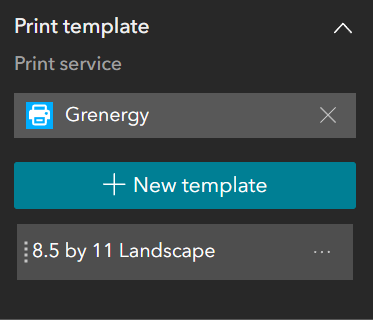

Has something changed with the Print Widget and custom print services?  As of Enterprise 11.4 and AGOL we are no longer able to use services that worked in Enterprise 11.3,etc.

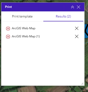

Hi @JohnLucotch2 ,
Does the error occur when the print widget selects this print service or when the map is printed?
Is there an error message displayed in the network or console in the browser's dev tools?

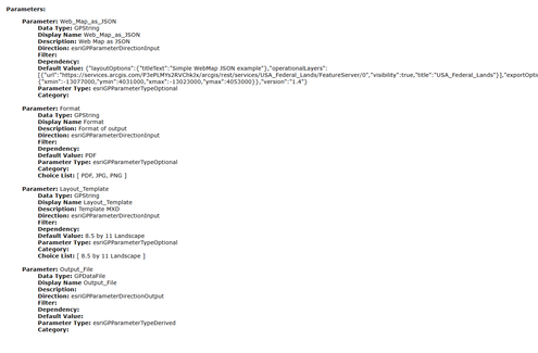

It would be very helpful if you could share the URL of your print service.
Thanks,
Shengdi
JohnLucotch2
@ShengdiZhang Here you

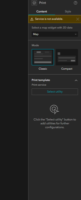

When we add it into the ExB Print Widget it says Service is not started even though it is.

Did you fail to add the Print service in ExB Print Widget or did you fail to print? And where did you see the message "Service is not started"?
Thanks
JohnLucotch2
Hey @BolanChen
After you add the Print GP Service as a Utility in ExB a red message appears in the config of the Print Widget that’s says Service not Started.  It happens in both AGOL and 11.4 Enterprise. It works fine in though in 11.3 Enterprise.
