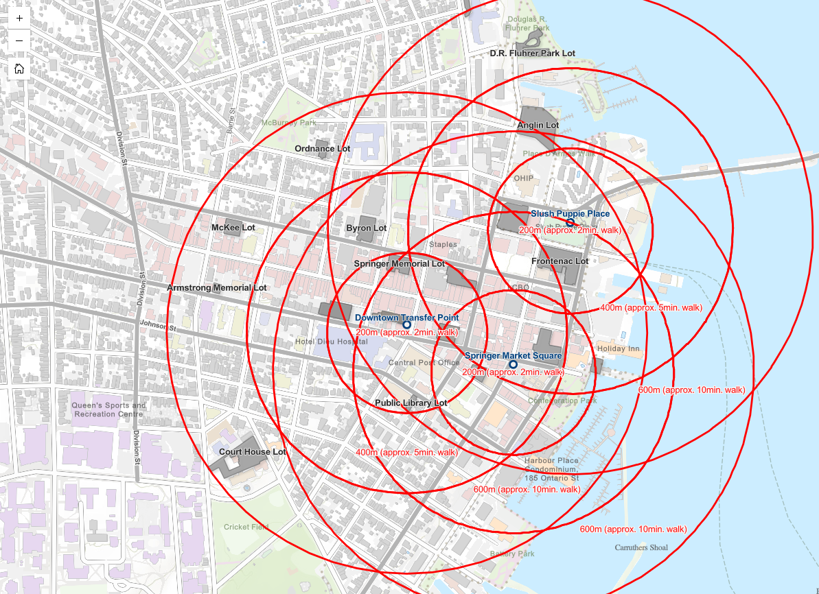

Hello,
Is it possible to hide/turn off features in a map widget in experience builder until the user clicks a button, which would turn the feature on? The app that I'm creating shows approximate walk distances from points of interest on a map. I've configured buttons in a list widget that, when clicked, only shows the walk distances for a specific point of interest. Currently when the app is opened, walk distances for ALL points of interest appear making the map look very cluttered.

Awesome, thanks! I want to make my app as intuitive as possible and this is a great solution. Here's what I did:
- add a filter widget to my app
-and a new filter (OBJECTID is -1 OR Location is Predefine unique values)
-check the radio button to Apply this filter automatically
This configuration gives the users a pre-defined list of my points of interest to select from and only displays one at a time (assuming they don't turn off the Point of Interest radio button)
