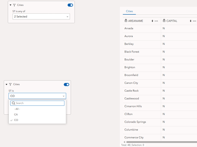

Between two different filter widgets, the current logic should already fulfill your case. For example:
See that in my first filter, I chose two states, CA and CO, then the table filters:

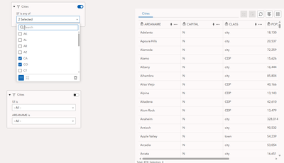

At this time, the second filter will respond automatically to the two chosen values, and the list shrinks so that you can further filter:
I use the same DS for these two filters.
