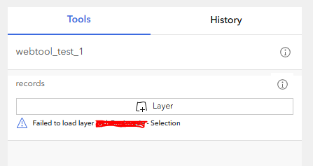

I created a simple webtool today to test this functionality in Experience builder, and it doesn't seem to work in my case. I want to create a webtool that works with a sleection of records as input. For this I created a simple notebook with one parameter and published it as a webtool.
Then created a basic experience with just a table and the analysis widget. When i try to set the analysis tool input from the selection in the table I get this message:

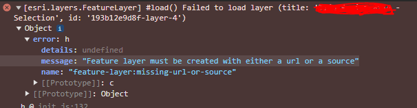

When i look in the console we see this error:
Am i doing something wrong or am i encountering a bug?

No the GP widget does not respect selections at all yet.  Which is super weird to release it without that.  No one runs a tool on an entire FC.
See farther up this post there is a hack posted.

Hi @GFlonk , I guess the data you used as input is a private feature service hosted in some portal?
GFlonk
Yes it is, though my account has access to it. I think what would help here is a simple step by step doing only the necessary to verify that in experience builder; we can add a table with data, and send its selection to a webtool, then in the webtool verify we receive a selection (only by printing or something). If i have that i can verify that flow works and could be a possible solution for clients i have. I tried doing exactly this myself and ran into the error i mentioned earlier.
Wei_Ying
That's weird. I cannot reproduce based on your description. I guess it might be tool specific or data specific.
I suggest you to contact Esri Support to provide us a repro case.  Appreciated!
