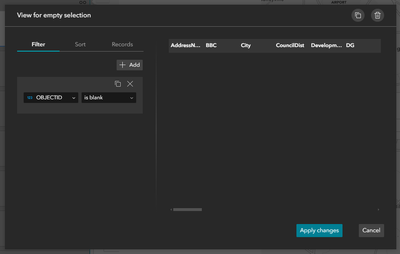

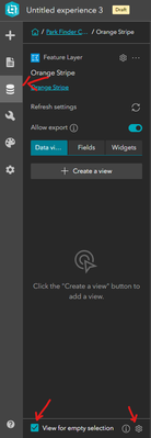

Try this. Go to the Data Tab on the left-hand side of the screen. Then find your buildings layer. At the bottom of the panel check on the View For Empty Selection Button. Then press the gear icon next to it.
Now make a filter that won't find anything. OBJECTID is blank should always return no results.

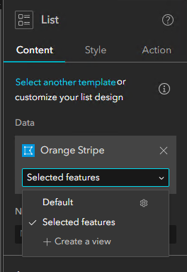

Set the Data View in your List Widget to Selected Features. If you have any dynamic content already configured in your List, you may need to re-configure it.

  1. Set up your Table Widget and your List Widget on a Selected Data View as above.

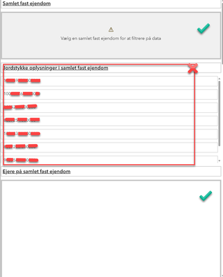

For some reason I can't do the same with a building polygon within the lot. The list including building polygons are showing all the building data when opening up the app, even though nothing is selected:
When I select a polygon it filters out correctly and select the buildings inside of the Lot.
In the list it should only get data of selected features, so I'm a bit lost here, I'm hoping for a solution.
So all the tables works with selected features from a polygon layer, but I can't get the polygon layer to work., where it should only show the building with the matching ID's when a Lot is chosen, and not when it's unselected.

Thank you Jeffrey, that worked perfectly. A long way to that end goal, but it was worth it 🙂
I was actually close to it, I added ObjectID == -1, however that wouldn't then show anything, now I have not data when nothing is selected, and everything is filtered and selected when a polygon is selected.
