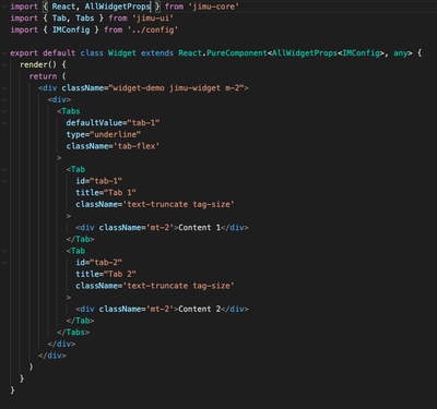

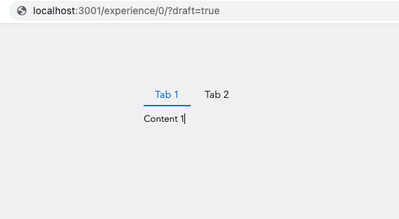

TonghuiMing
Hi @AlejandroMari1
After discussing the problem with developers on the team, here is some information for your reference -
We've tried the Tabs component inside ExB v1.5 and it works fine, the code and result are as follows:
The issue you've encountered seems to relate to how this component was being used. Telling from the error, it happened when the component read theme variables - not getting the correct ones.
