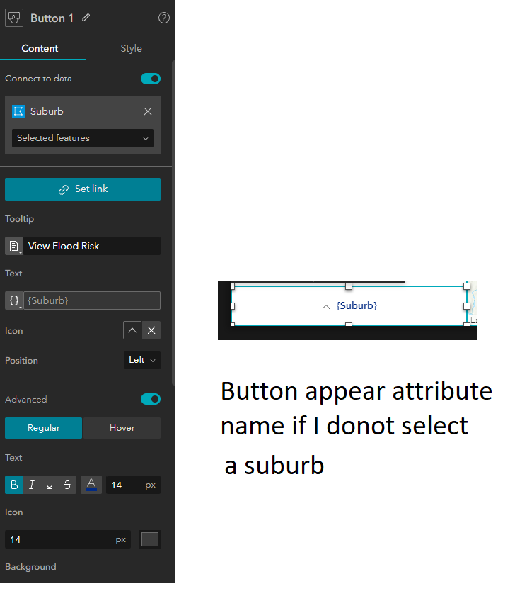

Hi
I am working with Experience Builder and button widget
I connect the button with the suburb layer, so each time I select a suburb will appear in the button the name of the suburb but if I do not choose any suburb to appear by default the name of the attribute. Is there any way it has a text like "Select a suburb" instead of the attribute name?
Thanks

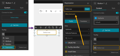

TonghuiMing
Hi @Greta
There is a way to achieve what you want, by using Expression as dynamic text rather than Attribute directly:
Hope it helps.
TonghuiMing
Hi @Greta
Hope it helps.
