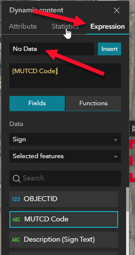

One "workaround" is to enter the dynamic text as an expression (instead of Attribute) and give the expression a name like "No Data", or whatever you want to appear when there isn't a value.
Then, if there is no data in that field for the selected feature, it displays the Expression title, not the expression itself.
Didn't seem to work at first, but just re-tested and putting a space as the Expression name makes it "appear" to be empty when no data.

Clever. That's a good one! Would be good though if this could get looked at in the future by the developers.
