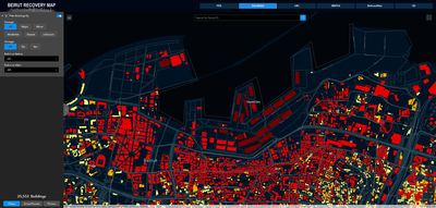

The Beirut Recovery Map, referenced in another post, has building filters in the SSL/NASA tab configured in a very concise way and seems to be a reasonable workaround for the lack of a clear all filters/filter reset option. One of the ways that a clear-all-filters effect is created is by having an "-All-" option combined with enforcement of a single filter selection at a time from each of the multiple attribute categories. I was under the impression that we're stuck with multiple selections in the widget, with no option to enforce a single selection... @BrunoSousa1, it looks like you're the author of that awesome app. Did you set those filters up & could provide insights on that workaround?

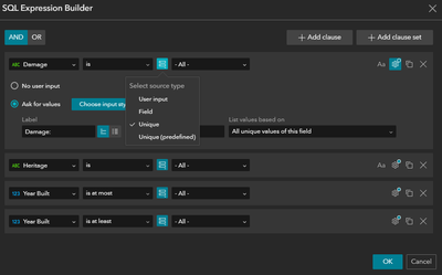

Hi,
Yes, I set them up.
This is how the queries for that filter look like:
As you mentioned, to have the "All" Option, the filter must be set for Single selection.
There might be some other workarounds using only the List Widget to filter, however I haven't been able to make it work yet.
