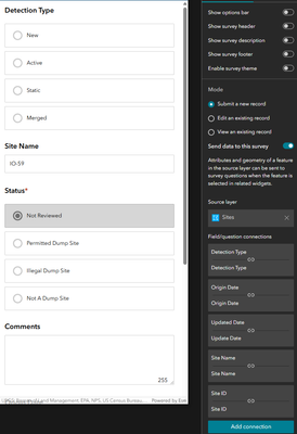

Any ideas why 1 connection does not send data to survey in the Survey widget in Experience Builder?
The survey was created using Survey123 Connect. All other connections work correctly apart from Detection Type.

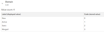

  • Question type is select_one esriFieldTypeSmallInteger
  • Integer domain does match the feature layers
  • In the XLSForm, everything is blank apart from the field type
nworbi
As all my data currently has the '0/New' value, I didn't realise that other values show in the survey as expected. For some reason, it is only '0/New' that results in a blank
JuanTomásMartinez17
This explains the issue completely.
Since 0 is treated as a false value in JavaScript, it causes a compatibility issue when passing data between widgets.
A good workaround is to start the codes from 1 instead, or to use string values instead of numbers.
