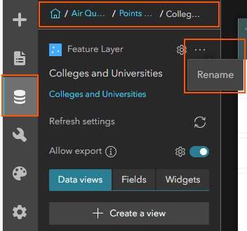

In any case, you can change the name in Experience Builder by going to the Data tab, clicking on the data source (in your case, the web map the layer is in), then clicking on the layer. Once you get to the layer details, there'll be an ellipses icon in the upper right. You can rename it there.
JasonFitzsimmons
that worked, thanks!
