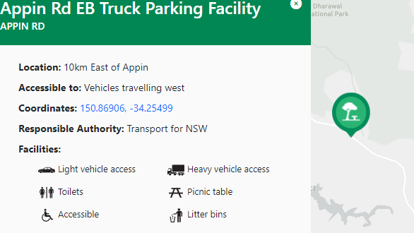

Hello, I wish to replicate something along the lines of what is being done in this application, where you select a point feature on the map and at the bottom you will see icons based on whether a particular attribute is TRUE or FALSE. Rest Areas (nsw.gov.au)
The attribute table looks like so:
has_bbqFALSE
has_caravan_disposalFALSE
has_emergency_phonesFALSE
has_lightingTRUE
has_litter_binsTRUE
has_picnic_tableTRUE
has_playgroundFALSE
has_power_outletsFALSE
has_shelterFALSE
has_toiletsTRUE
is_accessibleTRUE
Is there a way this could be easily replicated in Experience Builder, using ArcGIS Pro, Web Map Viewer, or directly within Experience Builder in which it will ultimately be consumed.

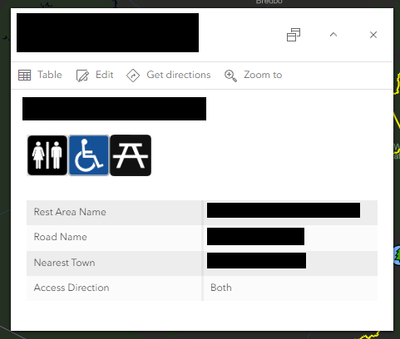

NigelGriffiths

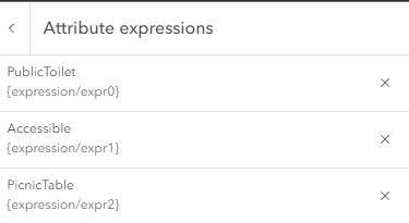

Thank you very much for your suggestion. I was able to achieve the desired result by having an arcade attribute expression for each field and image, then having a text element above the fields table that included the expression in HTML code.
Desired result below
Arcade expression used for each image
var checkvalue = $feature.has_toilets
var img_show = 'https://imageurl.com'
var img_blank = ''
iif(checkvalue=='TRUE',img_show,img_blank)
The following HTML code was placed into the text pop-up element
<img src="{expression/expr0}" width="50" border="0"><img src="{expression/expr1}" width="50" border="0"><img src="{expression/expr2}" width="50" border="0">
 I am unsure if your method is the better solution, as I have limited experience with Arcade so was unsure how exactly to implement it.
