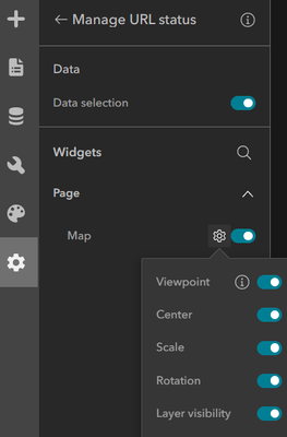

You may find this workflow useful, with the combination of turning on the App settings > URL parameter for map widgets:
https://community.esri.com/t5/arcgis-experience-builder-blog/embed-with-url-parameters-1-3-obtain-ur...
If the syntax for your embedded app and ExB parameter share the same key, then you can give it a try and see if it works.
