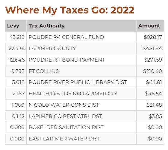

I am trying to make a snappy looking page on experience builder. Basically, on another page view on this ExB, a person can select their property on a map and see some basic details. On this page, there's info about the selected features. I want to grab some cells from the database about this property and put them into a snappy looking table (see the attached version from another county). But in the example I'm showing, the data are in two columns that would be both the field names in my database and then the info from one row about one property.
If I insert a table widget then it's going to give me just one long row with columns for all of the things I'd like to show. If I insert a feature info widget I get it displayed vertically, but it's showing more rows than I want for this dataset (I have another view that uses the feature info widget so I need to use all that info in that other view).
The only thing I can think of is to stack text boxes with dynamic text in a block. This seems terribly time consuming and wasteful. Is there another more elegant way to transpose date from the attribute table into a vertical table?

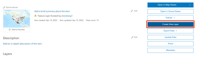

  • In ArcGIS Online or your Portal, create a view layer from the layer you use, select only fields you would like to display

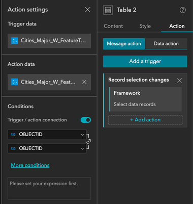

  • Configure a Record selection changes action from the widget you would like to interact with (I used a table as an example), target the framework and choose this field-customized view layer as target dataScreenshot 2023-04-12 at 16.40.51.png

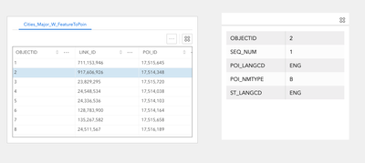

  • When switch selection from table, record in feature info will change accordingly, with fields you specified in the view layer.
