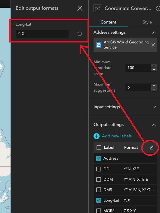

I am curious how this even happened.

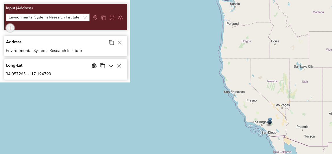

I am looking to edit some things in Coordinate Conversion and want to rename something. Thankfully I can edit the Lat-Long output (X°‎, Y°‎ > Y, X). But why can't I edit the label?? It stays as the default of "Long-Lat":

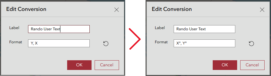

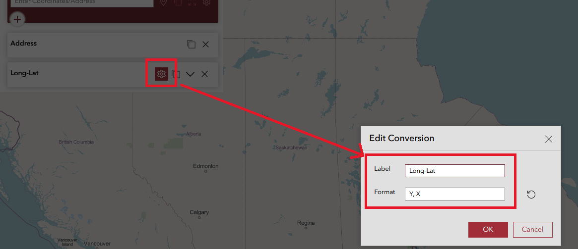

But it's not like they don't know people would want to edit the label since the End User can:
But there is more... The End User gets a "reset" button. And when you press it... It only resets the "Format" while completely ignoring the "Label" field!
Am I missing something here, or is this actually how this works?

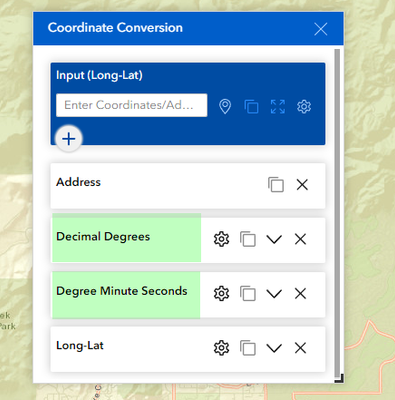

DavidDas__GISP
You can change the Labels in the Coordinate Conversion Widget in the Developer Edition of the Experience Builder.
Here is an example:
Before
DD
DMS
After
Decimal Degrees
Degree Minute Seconds
To do this, you must edit the config.json files.
