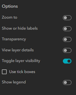

What I meant is that you can have all 90 of your layers in the Map Layers widget with the Toggle Layer Visibility option on. This should allow users to turn on/off layers.
The layers set by the Bookmarks widget will override choices made in the Map Layer widget so the Bookmarks will set the main theme and if a user needs another layer they can find it in the Map Layers widget.
This option should be available in all versions of Experience Builder.
