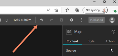

If you are lucky enough to have not closed the experience yet, the undo button still works after a save/publish.
If still open, you can undo the changes, save, re-publish.

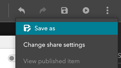

@JulieMikolajczyk Yes, unfortunately, what @RhettZufelt mentioned above would be the solution. If the app has been saved, then for now there is nothing you can do to revert it back.
For similar cases, be careful with the Save function since it WILL update your app config. I would say the silver lining here would be, to use the Save as function more often, if there are multiple branches or versions, or from multiple editors:
