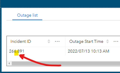

Hello! I'd like to remove the thousands comma separator in the table I have in an experience:

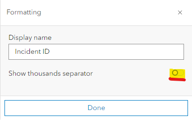

I tried going to the visualization for the feature and unchecking the thousands separator. Also tried pulling the data from a web map where I did the same with no luck:
