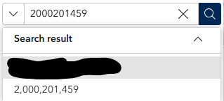

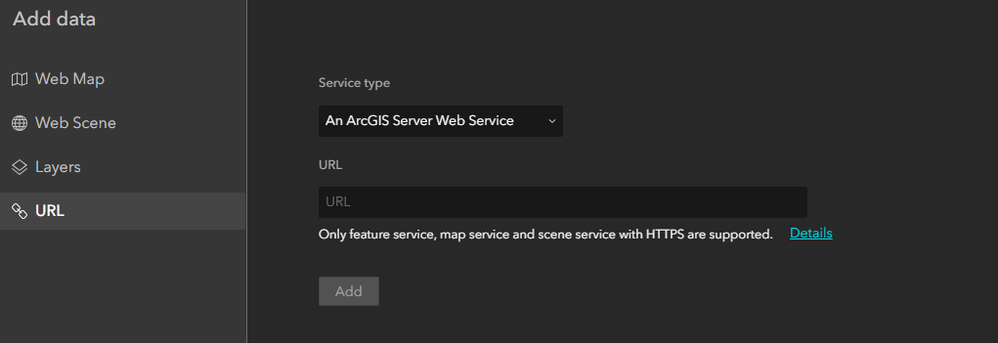

DanCopKac
how do i fix this issue in the search widget's result? The map service was added via URL, so it's only part of the Experience, it's not part of a web map so I can't change the settings in the web map.
