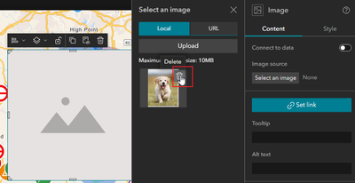

Does anyone using Experience Builder added many embedded images into their apps?  I ask because an Experience app was created at my org with many embedded images and the Experience hit the 1,000 resource limit making the app unusable as resources cannot be deleted from being referenced by Experience Builder even though the embedded images were deleted.
Using the below URL for monitoring resources in the Experience
https://support.esri.com/en-us/knowledge-base/problem-unable-to-add-resources-to-an-arcgis-online-it...
AllenZhang
Hi @MikeVolz . Did you delete the images in the image selector? Because unselecting images for widgets won't delete them automatically.
After delete them, save the app and refresh. The image resources should be cleared.
