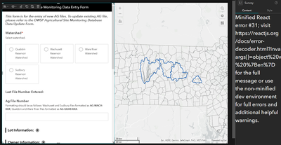

This had been configured and working well, however, I switched the "source" layer (source of the geometry/attributes) in my web map and need to re-connect the layer to my Survey123 form within Experience Builder to continue passing this information from the web map/selected layer into Survey123. When I go to re-configure the Survey element in Experience Builder, I see this error in the config pane on the right as soon as I try to make a connection between the layer in my map and the form. See screen capture below.
Error:
Minified React error #31; visit https://reactjs.org/docs/error-decoder.html?invariant=31&args[]=object%20with%20keys%20%7Ben%7D for the full message or use the non-minified dev environment for full errors and additional helpful warnings.
I have tested in Firefox and Chrome and see the same problem. Attached is a screen capture of the issue.

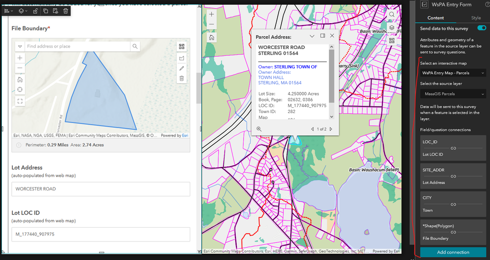

Yesterday, I republished my Survey123 form using an older version of Survey123 Connect that I had on my computer. I republished the XLSForm from version 3.15.175. Before republishing, I removed my pulldata @ layer function since this is not supported at version 3.15.xxx. When I opened my Experience Builder app, it was working perfectly and I was able to rebuild the connection between my Map and Survey widgets. I saved and published ExB. I then opened my XLSForm in Survey123 Connect version 3.16.110, added the pulldata @ layer function back in and published the form. I opened the published ExB app and was able to successfully use the map/survey together. The information from the map passed into the Survey123 form and I could submit.
Screen capture below from right after republishing from Connect version 3.15.175.

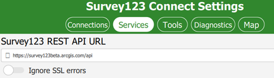

I tested option 1 and it seemed to work, but because I was uncertain if I did it correctly, I also tested option 2. I launched Connect, opened settings > service and changed the URL to the one you've specified (see second screen capture). I clicked OK and then opened an existing Survey123 form. I didn't modify anything and just republished it. Once that was done, I opened an existing Experience Builder in edit mode. I clicked the Survey123 form to see if the error still appeared, and it did.
Connect Services settings:
