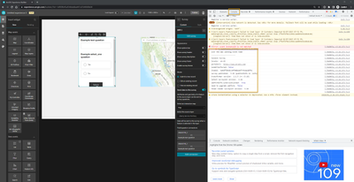

I am using Experience Builder to pass the geometry and attribute information from a feature layer in a web map into a Survey123 form I own.
This had been configured and working well, however, I switched the "source" layer (source of the geometry/attributes) in my web map and need to re-connect the layer to my Survey123 form within Experience Builder to continue passing this information from the web map/selected layer into Survey123. When I go to re-configure the Survey element in Experience Builder, I see this error in the config pane on the right as soon as I try to make a connection between the layer in my map and the form. See screen capture below.
Error:
Minified React error #31; visit https://reactjs.org/docs/error-decoder.html?invariant=31&args[]=object%20with%20keys%20%7Ben%7D for the full message or use the non-minified dev environment for full errors and additional helpful warnings.
I have tested in Firefox and Chrome and see the same problem. Attached is a screen capture of the issue.

For option 2, could you please help check the following places in the developer tool? Use F12 on the keyboard to open the developer tool, while the developer is opened refresh your Exb app.
1. The survey version printed in the console, like the following screenshot. This will give us the information of your publish version.
2. The webform in the network, like the following screenshot. We will need to check the format of the label, it should be a string instead of an object if you republished the survey using BETA api. The object will lead to the error you encountered.

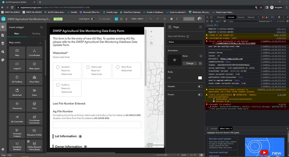

Hi @Ruth_JiatengXu -
Here is what I see for Survey version via Developer tools. I think it looks the same as yours:
I am not sure I understand what you're referring to in step 2. I can get to where you're asking me to go, however I am unclear as to what should be a string and not an object. When I expand the 'questions' section and then dig into my fields I see that all have a fieldType of esriFieldTypeString except for 2 of my queries which are null because I do not want them stored in the final hosted feature layer.
