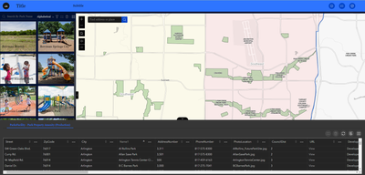

It can be done. Here is a two sidebar page. Neither sidebar interferes with the map. I shoved the whole sidebar with my map and list into the first side of my second sidebar.

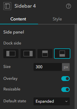

@JeffreyThompson2 thanks for that, it works!  I noticed that the bottom sidebar when it is expanded upward, it causes the map and side sidebar to shrink in height.  Would there be a way to accomplish a similar effect but have the bottom sidebar somehow be on top of the map and side sidebar, so that it can expand and collapse without affecting the size of those elements?  In other words it would be "on top".
JeffreyThompson2
MVP Frequent Contributor
If I am understanding your question correctly, you want to use the Overlay option.
GIS Developer
City of Arlington, Texas
Jamie_Leitch_CNF
@JeffreyThompson2 works like a charm!  Thank you!

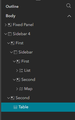

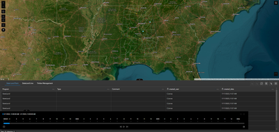

@JeffreyThompson2
I have two sidebars stacked. Please see screenshot below. Is there a way to use the space occupied by the bottom sidebar to scroll the table behind it? The table you see is in the lower section of the sidebar containing the map. As you can also see, I have intentionally left space on the right side so users can scroll either from that area or from the space above not occupied by the bottom sidebar, even when it is collapsed.
I would really like to extend the bottom sidebar all the way to the right while still being able to scroll the table behind it, either using the scrollbar on the side while the bottom sidebar is still expanded or from anywhere on the table once the bottom sidebar is collapsed.
