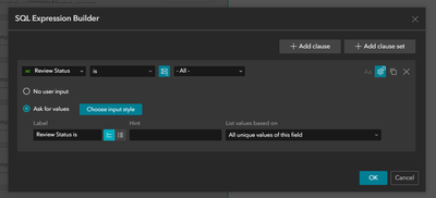

MichaelGaigg
Hi @ChrisRoberts2 - this is very easy actually, use the filter, either the built-in filter of the list widget or the filter widget itself. As long as the values you want to filter are part of the layer you display in the list, this works just fine.
There are two things to do when you build your expression:
- set the source  type (values you want to display) to Unique, or if you only want to show some,  the change to Unique (predefined) and set them there (this is also how  you'd  remove the "all" option if that's not what you want to include)
- change the input style from dropdown list to  pill selector
Good luck!

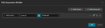

MichaelGaigg
Actually, if you want to remove the "All" option, you need to change the operator to "is any of", that will leave you with the available options only. Still set the input style to pill selector
RobertAnderson3
MVP Regular Contributor
Hi @MichaelGaigg
I love the pill selector option, this is what I'm using in my AGOL based ExB, two issues though.
With Unique (predefined) there is no Choose input style button, so the pill selector look is not an option?
With using is any of to remove the -ALL- it turns the filter into a select multiple, I want to keep it as a single selection filter, but without the -ALL-
So neither of these solutions really get me where I want to be with my filter.

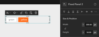

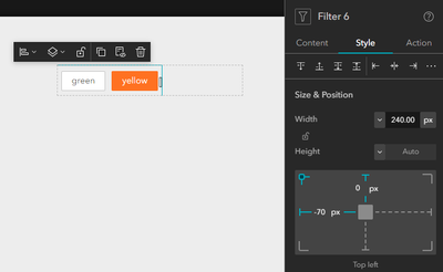

MichaelGaigg
@RobertAnderson3 yeah, last resort is to use Unique, which gives you exactly what you need (plus the all option), then wrap the filter into a fixed panel
and offset the filter itself by -70px (or whatever hides the all option)
RobertAnderson3
A bit of a goofy option for a workaround but I may have to run with that for the time being. The offset might be a challenge to directly offset considering different device sizes, but I'll give it a shot, thanks!
