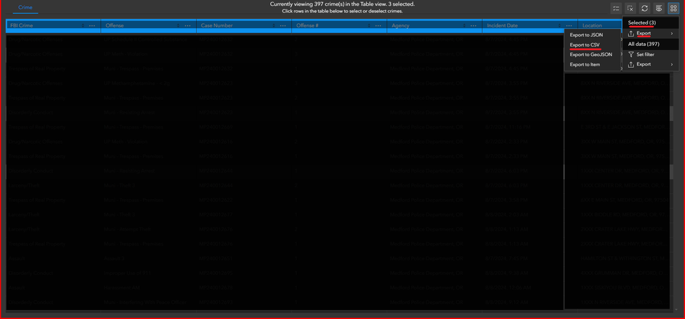

We have configured a Table View widget in the experience builder application, exposing some of the data columns. Here is the issue (along with the observed behavior):
  • When we export all the data in the table (Actions > All data > Export) into CSV or JSON or Excel or GeoJSON, all fields in the Table View are found in the exported file.
  • When we select a few features in the Table View and export them into any of the aforementioned formats, data in some fields are missing. This behavior is inconsistent, at best, as we have observed data in all the fields in the exported file just once.

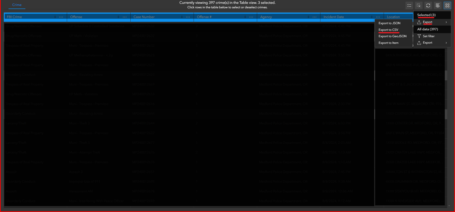

I am attaching the screenshots of what was done to get the exports:
This plate shows the Table View of the application built using Experience Builder (with 3 selected features, and Export to CSV) - data obscured for confidentiality.
This is the exported CSV:
FBI Crime,Offense,Case Number,Offense #,Agency,Incident Date,Location,Application ID,x,y
******,,,,,8/7/2024 4:45 PM,,233685,-13******.479,52*****.957
******,,,,,8/7/2024 3:55 PM,,233689,-13******.078,52*****.966
******,,,,,8/7/2024 6:03 PM,,233696,-13******.257,52*****.06
I've obscured the data in the fieds due to confidentiality. You will be able to notice that there is no data in the fields: Offense,Case Number,Offense #,Agency.
