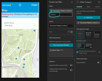

My goal is to have a user selected drop down, filter the points on map.
It appears the only way to filter a map is to apply the filter to the default data view.
  • Map changes based on the filter.
Filters have the option to select data views, only I cannot find a way to get the map to update.
  • Hoping I'm missing something in how the filter is applied.

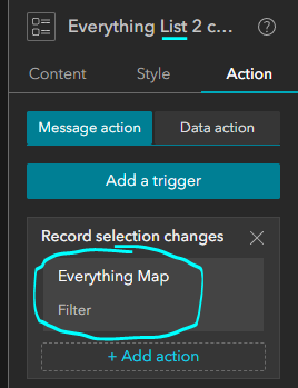

With the List widget there is an action to Filter the Map, however I have been unable to find this action on a Filter Widget
  • Is there a way to apply a Filter to a map in the similar way as a list?

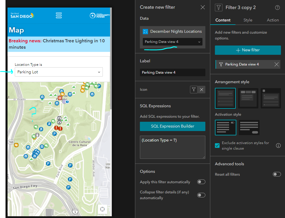

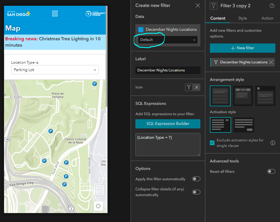

Does this mean that in order to visually show the results on the map, the filter widget can only be applied to default Data view?
  • Which means any created child Data views, would also have the same filter applied to them.
  • Hoping this does not mean I need to create copies of the map, in order to visually see the Filter selections on a map.
    • This would likely result in 4-6 identical maps, which increases any map changes by 6x.

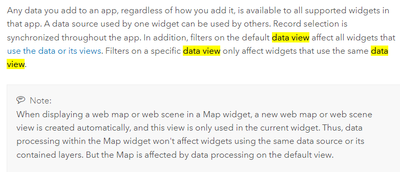

This is the designed behavior of data sources and data views. See details here - https://doc.arcgis.com/en/experience-builder/latest/build-apps/select-data.htm#ESRI_SECTION1_63589EF...
Thus,
- Filtering behavior is at the data source level, so the filter on each data view will not affect the original DS
- The original DS filtering will apply to all views created from it
- Map is using map view, which you can see as equivalent to the original DS
So, it doesn't matter how many views are created, if the filter-map interaction is expected, connecting the filter with the default data source would do. It will affect other widgets using child data views as well.

The way i have bypassed this limitation (i know ESRI have done too little with this widget). is to build a table widget with a filter option on it. The trigger an action to filter the map. its working fine.
