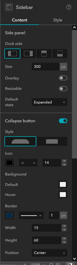

Using Experience Builder for developers (v 1.2), I want to use a side bar that covers part of the main stage content but can be collapsed to maximize page real estate. However, the content "underneath" the sidebar is unusable even when the sidebar is collapsed and the content is visible. Below, the buttons and drop-downs on the embedded dashboard under the sidebar outline do not work on the live application. I have to minimize the embedded content so that it is not underneath the side bar when the side bar is extended for it to work.
I'm wondering if this is a bug that will be fixed in future versions or if there is a workaround anyone would suggest.  I like the pop-out bar for people who want to free up space for smaller screens, but it limits the functionality of even a basic web map if any of the map buttons are in one of the affected corners.

The map style was also set to stretch but I realized the winning setting was I had 'overlay' enabled which now I wonder what that does, but initially when I didn't have my map in the second panel of the side bar the overlay function was needed, but now I'll have to look into that.
The great news is the buttons now sit outside the sidebar!!!!!!!! Thank-you!

Ah. I'd never used the Overlay option, but here it sounds like it was behaving as expected. Good to know. Glad yours is working now too.

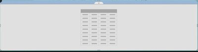

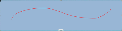

Hi All, I'm having the same issue with my map. Similarly to the old web app, i wanted my audience to be able to view the table behind the data at the bottom of my page, with a collapsible side bar, but to do this, the side bar settings goes to about half of my map, which causes the glitch when trying to move around it. Does anyone have a suggestion of how i can allow users to view and hide the table without causing this glitch please? If i move the sidebar panel down, it completely hides the table and then it cannot be viewed

Jamie_Leitch_CNF
