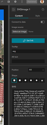

FredericPoliart_EsriAU
OK so in theory, I could create my own SVGImage Widget by
1. Cloning your \client\dist\widgets\common\image\
2. adding a new setting called "svg_data"
.. or is it easier to just upload the .svg somewhere public , and use the <embed> widget 🙂

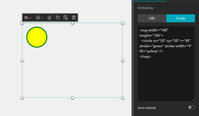

jcarlson
MVP Alum
The Embed widget allows you to embed by Code, not just by URL. Simply paste your <svg>...</svg> code there.
- Josh Carlson
