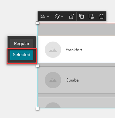

You can switch to Selected to configure the Selected state layout:

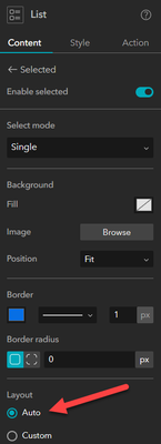

You can select the Auto layout in the list settings - State - Selected, to sync the layout between Regular and Selected states:

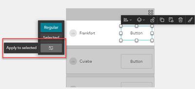

Or if you want to keep the Custom layout, you can select the button widget on the Regular state, and apply it to the Selected state:
